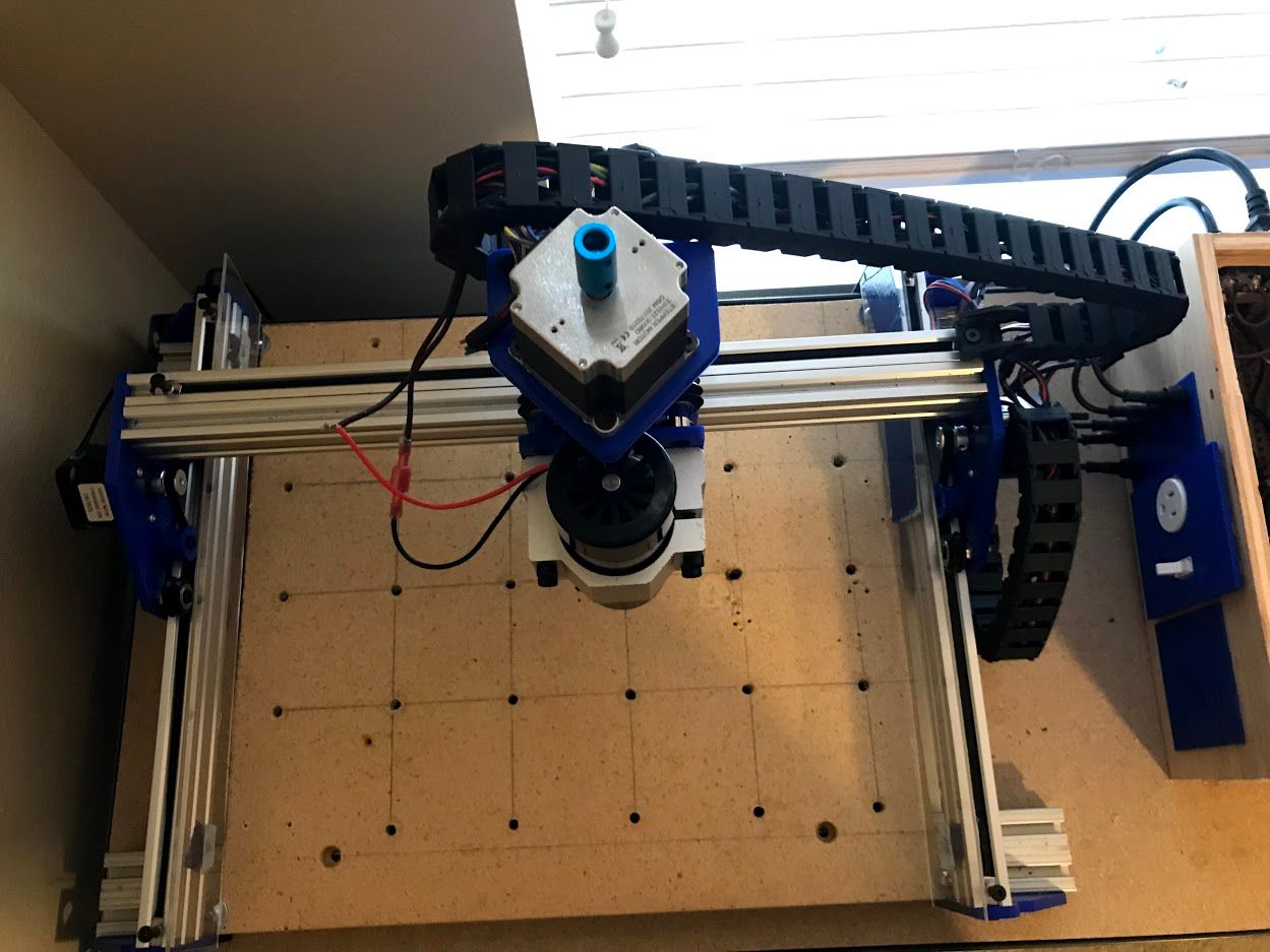

The area of travel for the cutting tool (500W spindle) is about 13" in the X, 9.5" in the Y and 5" in the Z, but this could be increased if longer aluminum extrusions were used. The gantry moves along the Y-axis via belt drive with motors on either side of the frame while the X-axis moves perpendicular to the Y-axis along the gantry, also via belt drive. Attached to the X-axis is the Z-axis, which moves up and down via screw drive. I've also incorporated mounting holes on the plates to allow the axes to be converted to screw drive, however this still needs work to mount the motors and make sure everything else lines up.
The Z-axis still has a basic attachment scheme, meaning multiple tools can be attached so long as an adapter is designed with matching mounting holes. For my purpose, my 500W air powered spindle can attach and I've created an attachment for my 2.5W laser. You could also design an adapter for a pen or even a 3D printer head to name a few options.
The overall cost of this machine ends up being around $325, not including the spindle or laser. I hope you find this Instructable useful if you decide to build your own CNC. There are a lot of resources out there for doing so, and I hope I've created something that helps centralize a small portion of this information.

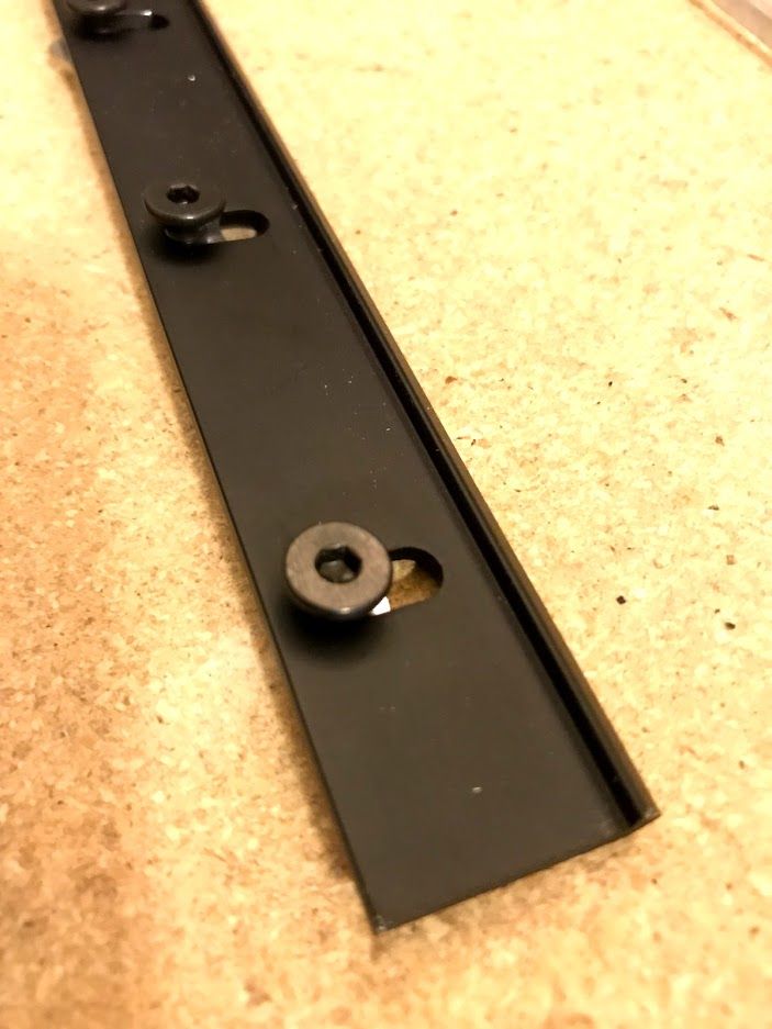

- The V-slot extrusion and V-slot rails need to be cut to length with a circular saw (see attached image or use dimensions for each piece in BOM)
- Use the self tapping screws to tap the ends of the V-slot rails so assembly is easier later. This takes some time and might be easier with a separate tap set.

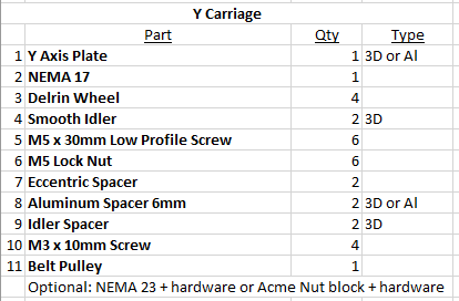

Step 4: Y Carriage
Materials:
Multiply all quantities by 2 so you can create both Y Carriages.
Note: The hardware included is for a 1/8" plate. If using a 1/4" plate then increase the hardware size by 5mm to 10mm or add counterbores to the plates.

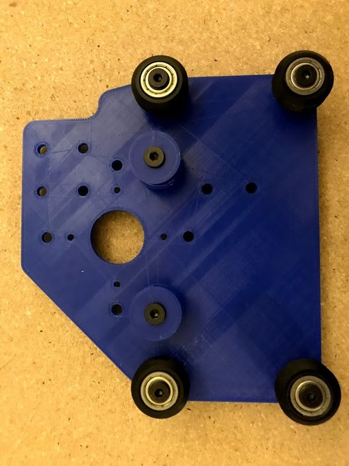

Steps:

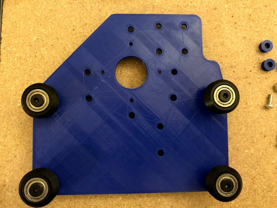

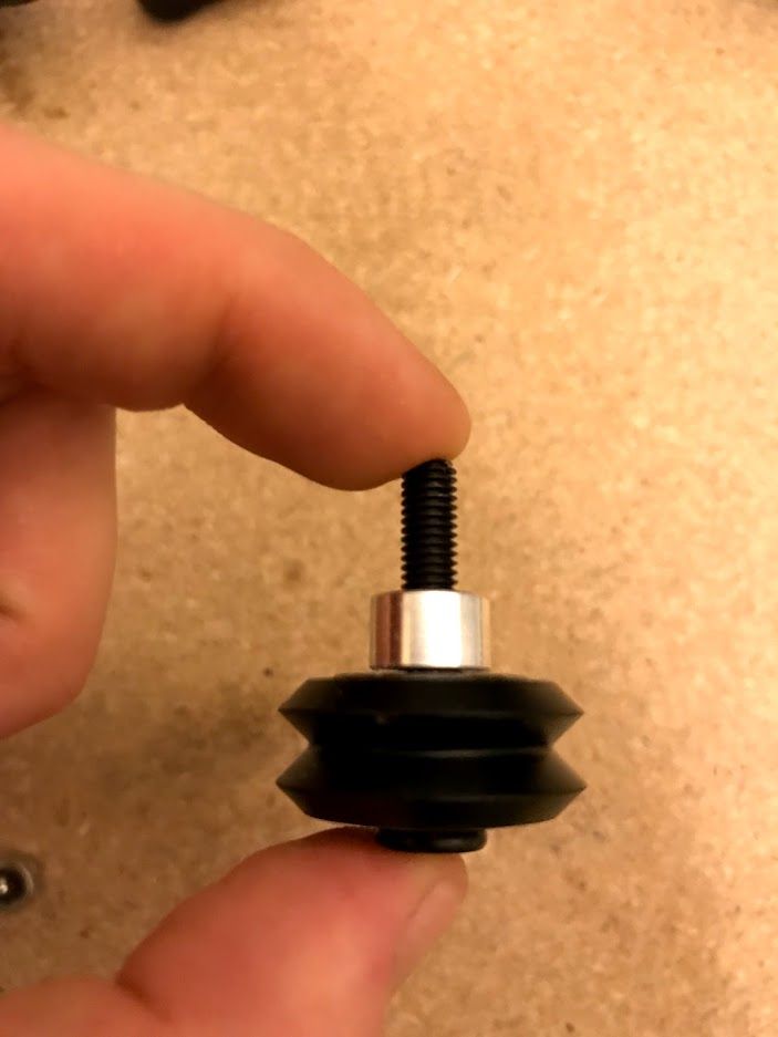

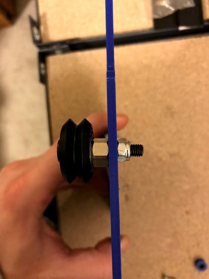

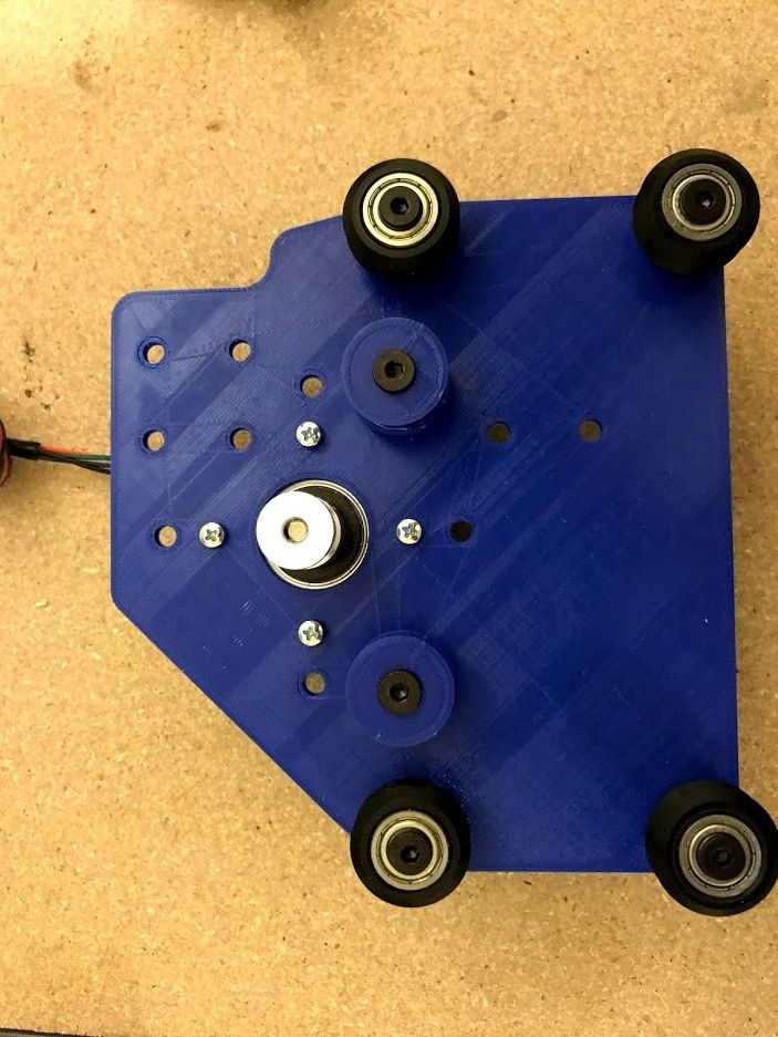

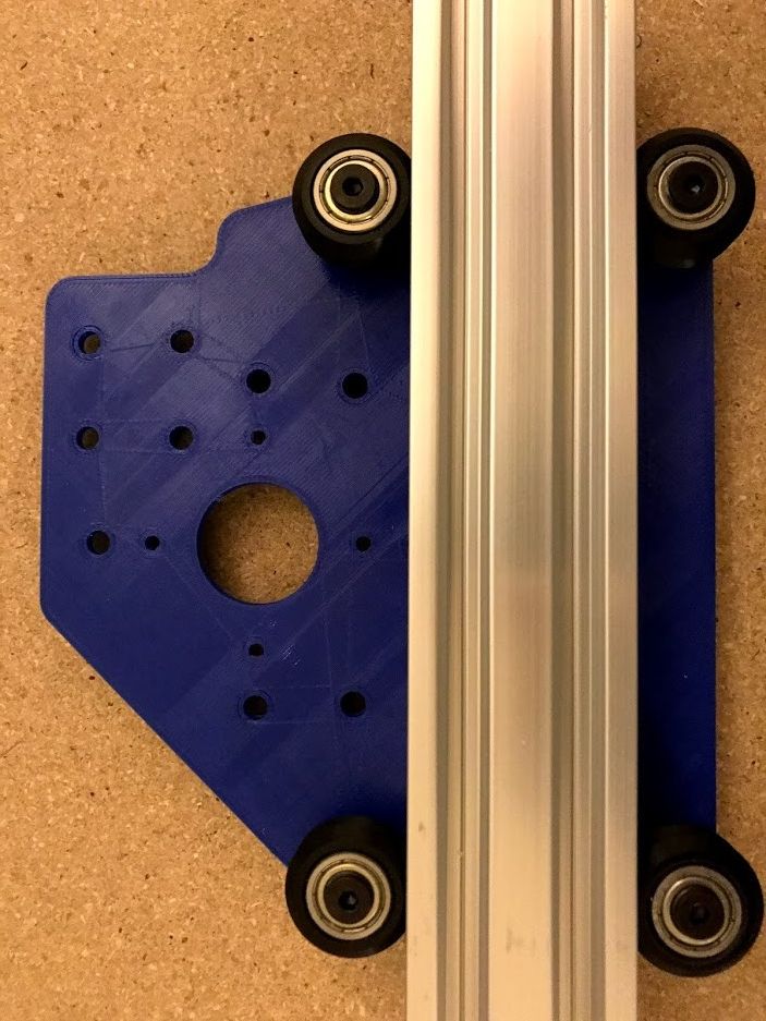

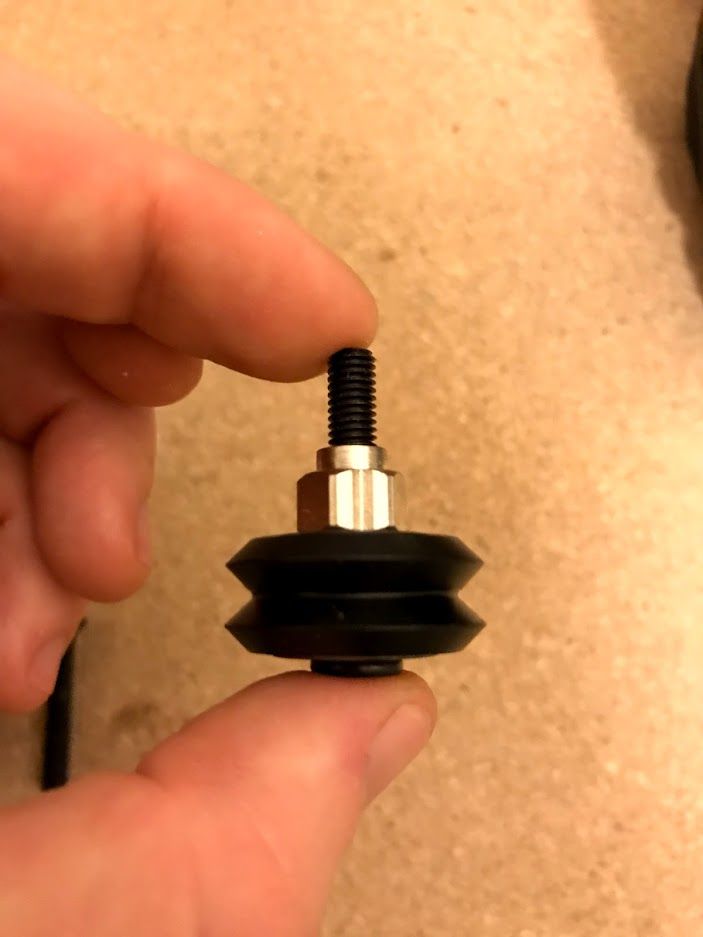

1) Assemble (1) M5 x 30mm Bolt through (1) Delrin Wheel and (1) Eccentric Nut as shown. Create (2) of these assemblies.
2) Put each assembly through each of the Eccentric Spacer holes in the Y Axis Plate. Make sure the Eccentric Spacer is fully seated in the plate. Tighten the other side of each bolt with a M5 Lock Nut.
3) Take the other (2) M5 x 30mm Bolts and assemble through (1) Delrin Wheel and (1) Aluminum Spacer 6mm each as shown.
4) Put each assembly through each of the two holes below the Eccentric Spacer holes in the Y Axis Plate. Tighten the other side of each bolt with a M5 Lock Nut.
5) Check the fit of the wheels on a Makerslide piece. The carriage should move smoothly back and forth and adjust the Eccentric Spacer to adjust the grip (this can be fine tuned later).

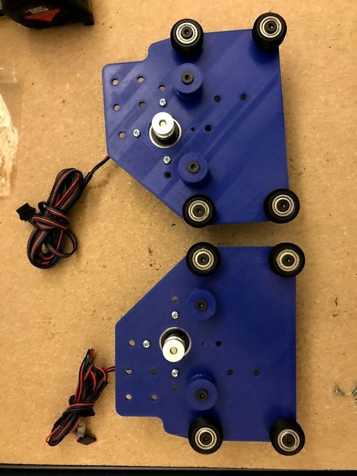

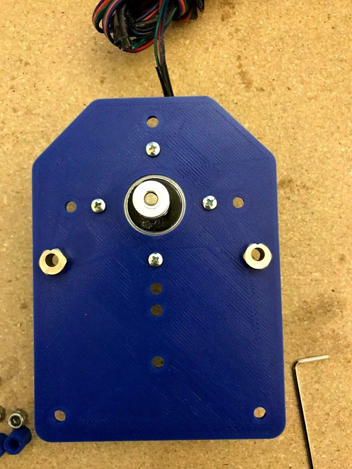

6) Take the last (2) M5 x 30mm Bolts and assemble each through (1) Smooth Idler and (1) Idler Spacer. Put these through the Idler holes on the Y Axis Plate and tighten with M5 Lock Nuts.
7) Attach a Belt Pulley to the NEMA 17 shaft. Attach this assembly to the Y Axis Plate using (4) M3 x 10mm Screws.
8) Repeat Steps 1 through 7 so you have a mirror image of this assembly as shown.

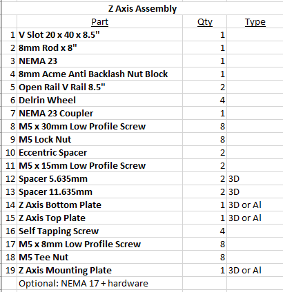

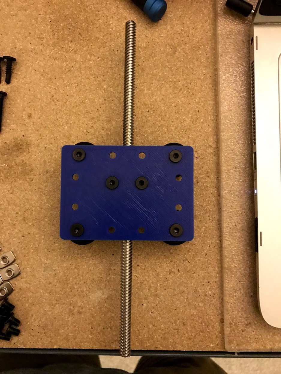

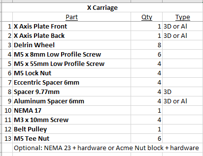

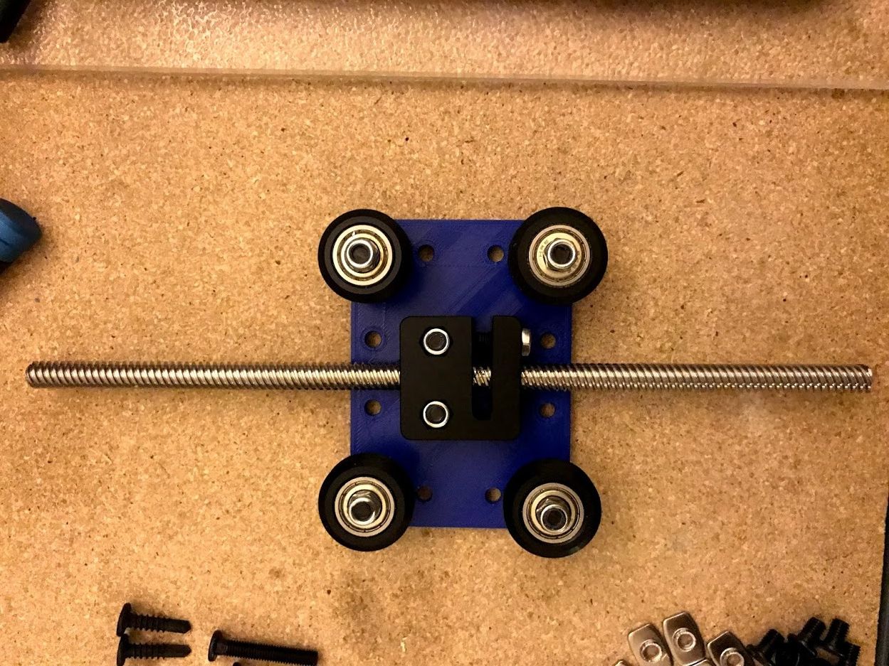

1) Assemble (1) M5 x 30mm Screw through one of the Z Axis Mounting Plate Eccentric Spacer hole. On the other end assemble on (1) Eccentric Spacer, (1) Spacer 5.635mm, (1) Delrin Wheel and (1) M5 Lock Nut. Repeat this for the second Eccentric Spacer hole on the Z Axis Mounting Plate.
2) Assembly (1) M5 x 30mm Screw through one of the Z Axis Mounting Plate holes opposite an Eccentric Spacer hole. On the other end assemble on (1) Spacer 11.635mm, (1) Delrin Wheel and (1) M5 Lock Nut. Repeat this for the second hole on the Z Axis Mounting Plate opposite an Eccentric Spacer hole.

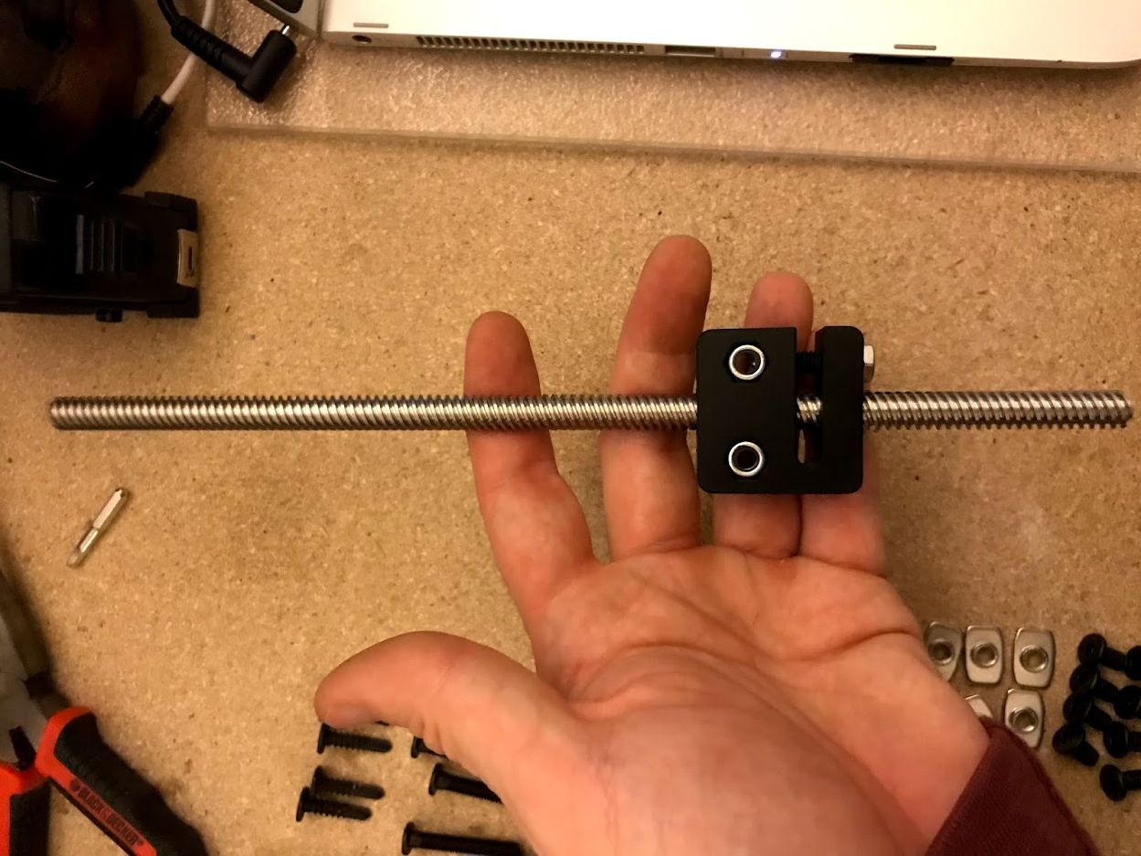

3) Assemble the Delrin Nut Block onto the 8mm Rod. (Note an anti-backlash nut is shown. I found this one to be too tight on the thread so I swapped it out for the Delrin Nut block).
Attach the Delrin Nut Block to the Z Axis Mounting Plate using (2) M5 x 15mm Screws and (2) M5 Lock Nuts.

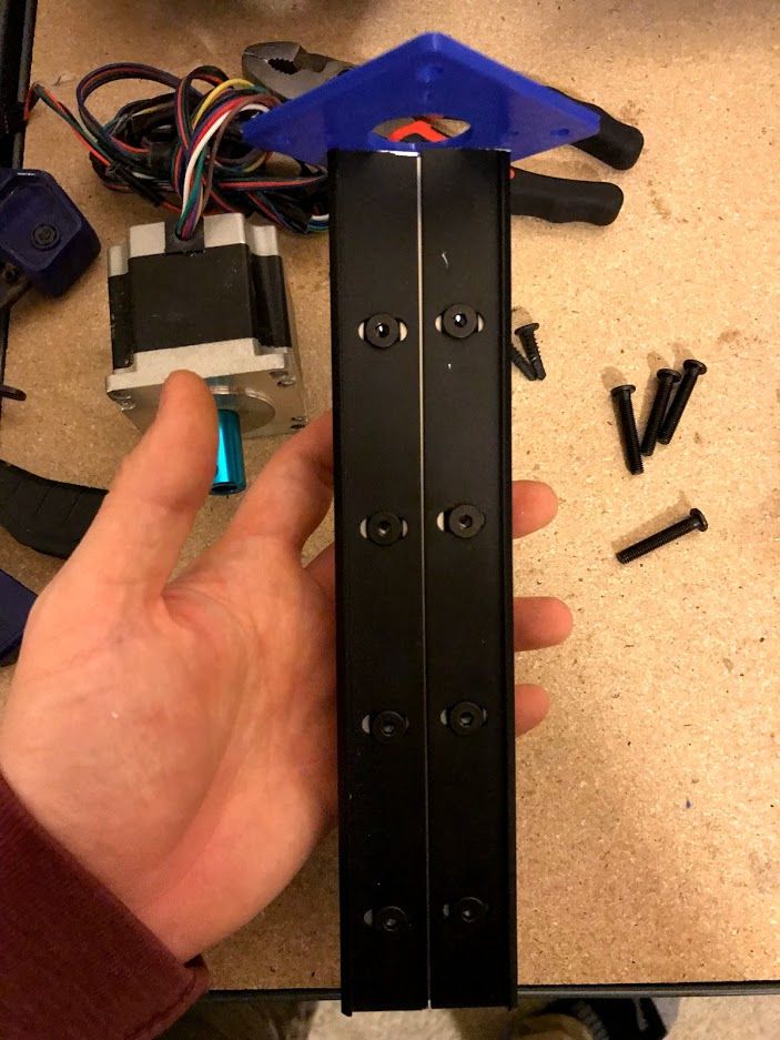

4) Take the V Slot 20 x 40 x 8.5" and attach the Z Axis Top Plate using (2) Self Tapping Screws. Note that the plate shown is a previous iteration. The actual plate is thicker and has other features so the motor doesn't interfere with hardware.
5) Take (1) Open Rail V Rail 8.5" and attach (4) M5 x 8mm Screws through the mounting holes and thread (4) M5 Tee Nuts onto the other ends. Note the image shows this assembled backwards. The recessed side should have the Tee Nuts against it.
Repeat this with the other Open Rail V Rail 8.5", (4) M5 x 8mm Screws and (4) M5 Tee Nuts. Again these assemblies are backwards in the pictures. If assembled this way then the spacing between the Z Mounting Plate and the V Rails will be off.
6) Slide the (2) V Rail assemblies onto the V Slot assembly. Make sure the bottom of the V Rails are flush with the bottom of the V Slot. Tighten the M5 Screws while making sure the lip of the V Rails are pushed flush with the V Slot. Again the V Rails are backwards in the picture. The lips on the far right and left should be flipped over to the other side (see the image in Step 15 below)..
7) Attach (1) NEMA 23 Coupler to the NEMA 23 motor. Attach this to the Z Axis Top Plate using (4) M5 x 30mm screws and (3) M5 Lock Nuts. There isn't enough clearance for the last M5 Lock Nut to be placed on the back corner of the motor so I just used the M5 screw to index the hole. Finally, slide the Mounting Plate assembly on the V Rails and into the NEMA 23 Coupler and tighten the coupler set screw.
The Z Axis assembly is now complete and will be attached to the X Axis Carriage next.

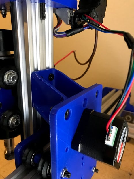

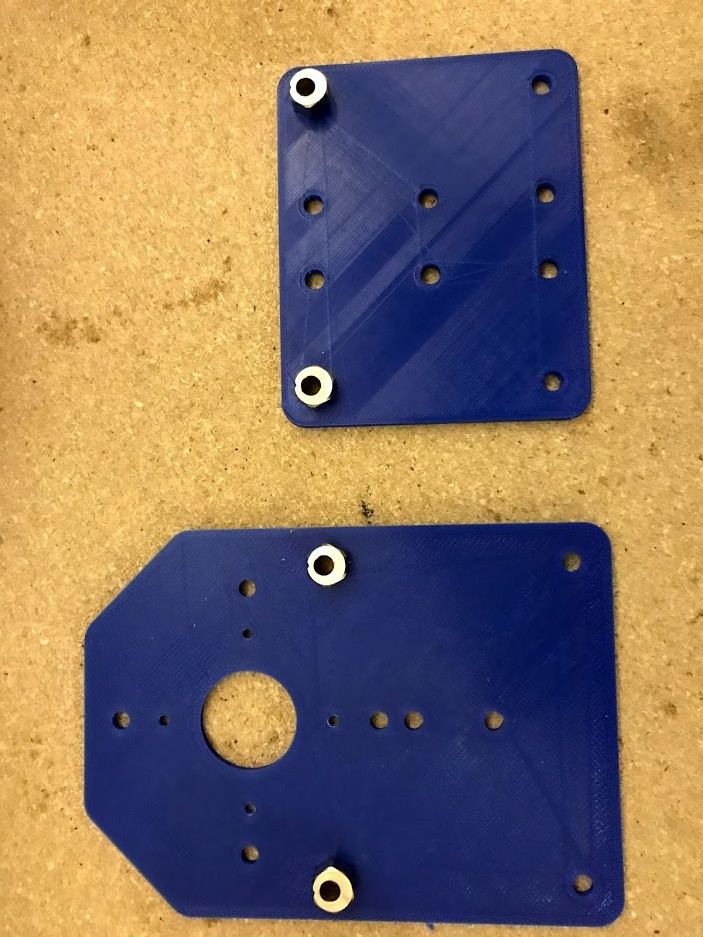

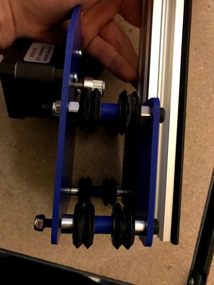

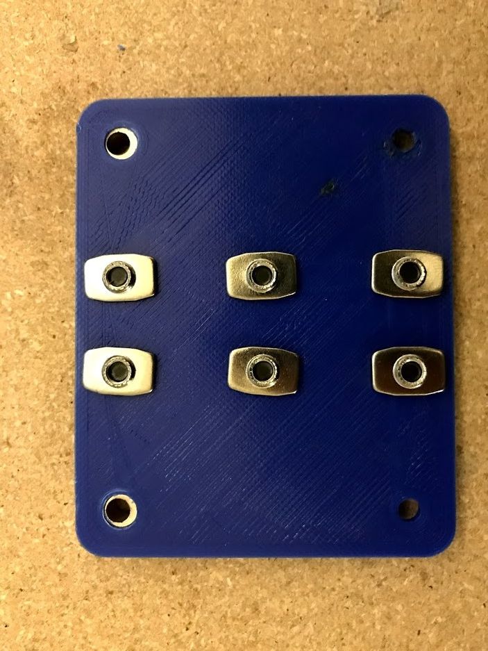

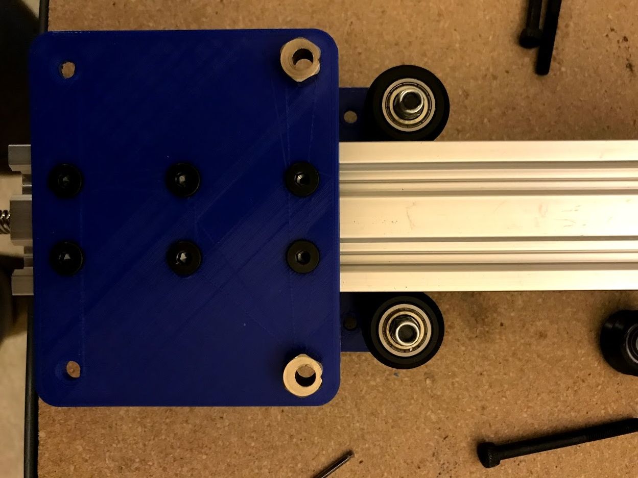

8) Attach (2) Eccentric Spacers to the X Axis Plate Front and (2) Eccentric Spacers to the X Axis Plate Back using the Eccentric Spacer holes.
9) Take the X Axis Plate Front and on the opposite side of the Eccentric Spacers attach (6) M5 x 8mm Screws through the (6) middle holes and secure with (6) M5 Tee Nuts.
10) Slide this assembly onto the back of the Z Axis assembly and make sure the bottom edges are flush. Tighten the M5 Screws to secure the plate in place.
11) Attach the NEMA 17 motor to the X Axis Plate Back using (4) M3 x 10mm screws. Also attach the Belt Pulley onto the shaft of the NEMA 17.
12) Assembly (1) M5 x 55mm screw through the X Axis Plate Front top hole, through the Eccentric Spacer then (1) Delrin Wheel, (1) Spacer 9.77mm, (1) Delrin Wheel and lastly the Eccentric Spacer and X Axis Plate Back top hole. Use (1) M5 Lock Nut to hold everything in place. Repeat this for the other top hole of the plates and make sure all Eccentric Spacers are seated in the plate holes.
13) Assemble (1) M5 x 55mm screw through the X Axis Plate Front bottom hole, through (1) Aluminum Spacer 6mm then (1) Delrin Wheel, (1) Spacer 9.77mm, (1) Delrin Wheel and lastly (1) Aluminum Spacer 6mm and the X Axis Plate Back bottom hole. Use (1) M5 Lock Nut to hold everything in place and repeat this for the other bottom hole of the plates.

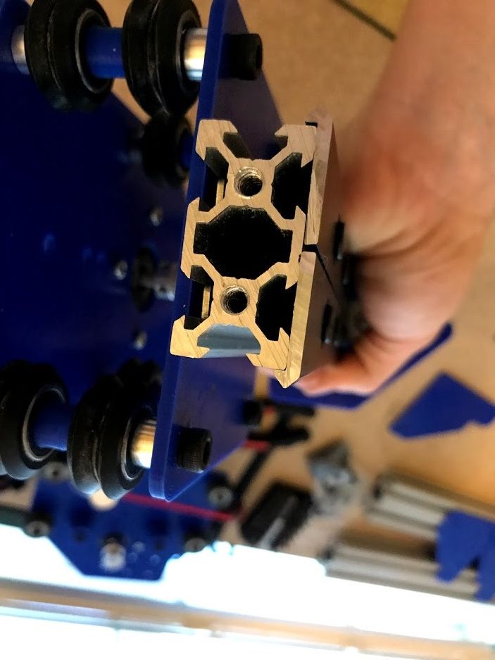

14) Check to make sure the X/Z Axis Assembly has the correct spacing by sliding (2) 20 x 40 V Slots between the Delrin Wheels. Adjust the Eccentric Spacers to so the carriage moves smoothly back and forth.
15) Attach the Z Axis Bottom Plate to the bottom of the X/Z Axis Assembly using (2) Self Tapping Screws.
Note the Threaded Rod still needs to be cut and should be flush with the Z Axis Bottom Plate. The V Rails are also still shown to be backwards. The correct orientation is like so:
The X/Z Axis Assembly is now complete.
Note in my assembly I also added in a support bracket between the X Axis Plate Front to stiffen up the assemblies.

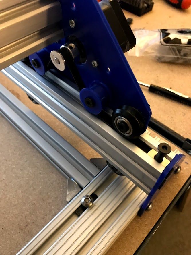

1) Take (1) Y Carriage and make sure it's well supported. Attach it to the (2) V Slot 20 x 40 x 19.5" extrusions using (4) Self Tapping Screws.
2) Slide an extra M5 screw and M5 Tee Nut into the extrusion then slide on the X/Z Assembly onto the extrusions. Slide a second M5 screw and M5 Tee Nut into the same extrusion. These screws will be used to hold the belt in place.
3) Attach the second Y Carriage onto the Gantry Assembly using (4) Self Tapping Screws. The assembly is now complete.

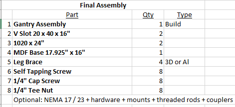

Materials:
Not listed:Belts, extra M5 screw and tee nut, 1010 x 12" extrusions and additional 1/4" cap screws, 1/4" tee nuts and brackets.
Steps:

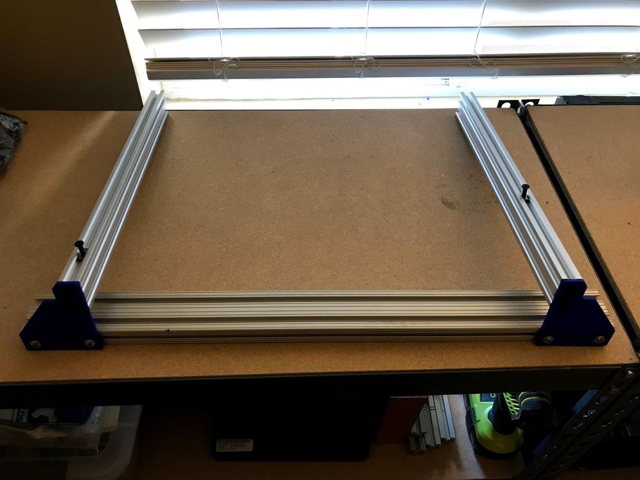

1) Attach (1) Leg Brace onto (1) V Slot 20 x 40 x 16" extrusion using (2) Self Tapping Screws. Assemble (2) 1/4" Cap Screws through the bottom holes of the Leg Brace and attach (2) 1/4" Tee Nuts on the other ends. Slide an extra M5 screw and M5 Tee Nut into the extrusion. Repeat so you have two of these assemblies.
2) Slide the assemblies from the previous step onto (1) 1020 x 24" extrusion so the flat edge is towards the inside of the extrusion. Don't tighten the 1/4" Cap Screws yet. Note you don't have to use the 1020 extrusion but can instead use another piece of V Slot extrusion and the appropriate hardware. I used this extrusion because I already had it lying around.

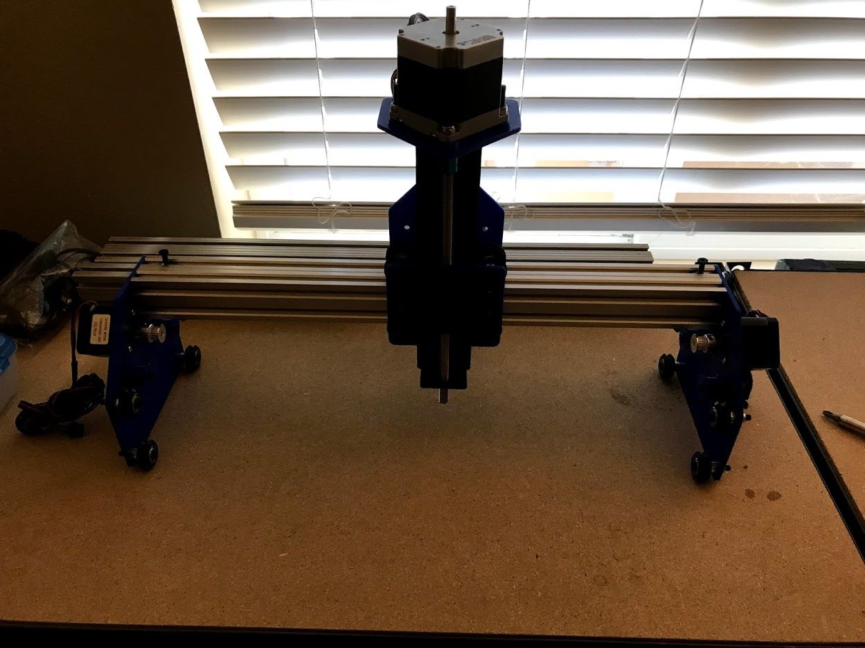

3) Turn the assembly 180 degrees and slide the Gantry Assembly onto the (2) V Slot extrusions. Slide an extra M5 screw and M5 Tee Nut into each of the extrusion.
4) Attach (2) Leg Braces to the (2) V Slot extrusions using (4) Self Tapping Screws.
Use (4) 1/4" Cap Screws and (4) 1/4" Tee Nuts to the 1020 x 24" extrusion.
5) Use a square to make sure everything is square before tightening the cap screws.
6) Attach some spare 8020 brackets to a 12" 1010 extrusion using some washers, cap screw and tee nuts. Slide these extrusions between the 1020 extrusions and tighten when square. I used (3) of these assemblies (one below each leg extrusion and one in the middle of the machine).
Make sure everything is square and then tighten all the cap screws.

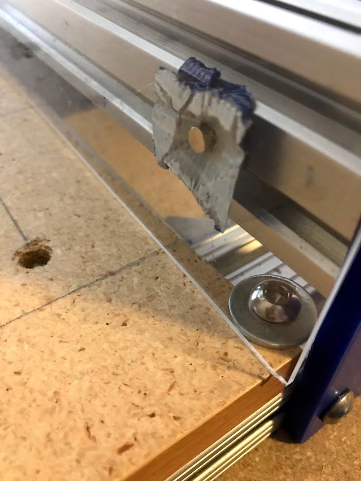

Once everything is tightened then testing moving the axes around without the belts to make sure everything runs smoothly. Tighten or loosen the Eccentric Spacers as necessary.
7) Thread (1) Belt under (1) of the M5 screws and tighten the screw to hold the end in place. Feed the belt under the Smooth Idler, over the Belt Pulley and under the other Smooth Idler.
Slide the other end under the other M5 screw and pull the belt tight to apply tension. Tighten the screw to hold the belt in place. Repeat this step for the other Y Axis motor and X Axis motor.
8) The mechanical components of the machine are complete. I also slid some cap screws into the 8020 extrusions to help fix the wasteboard (shown in the second image). Also shown is a plexiglass shield I have on either extrusion attached by magnets.

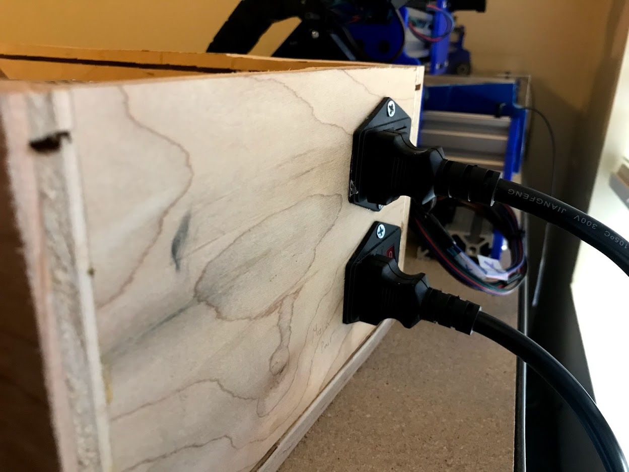

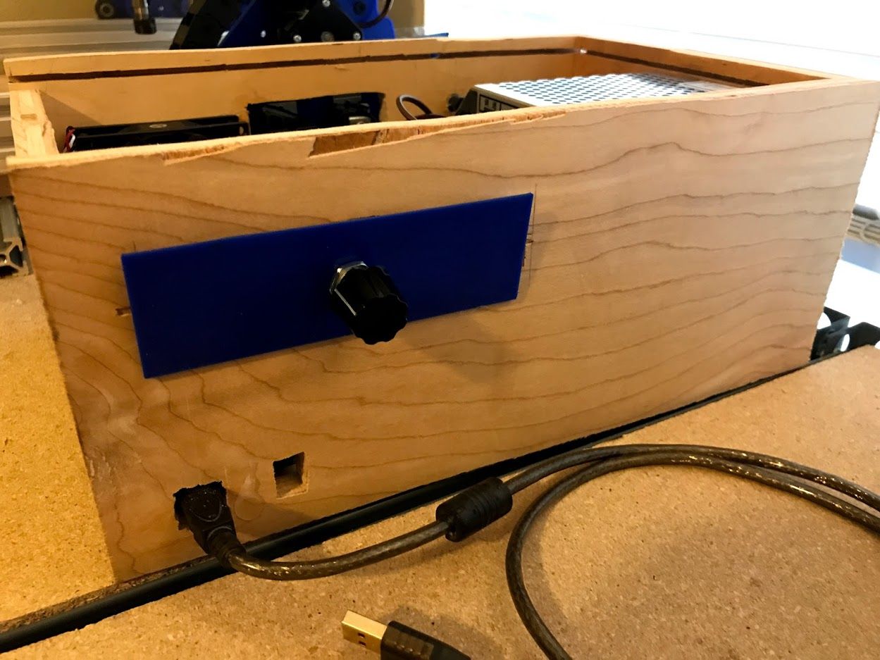

Once I had all the electronics working again I routed the cables to the back right of the machine through various drag chains.
I then laid out the power supplies and other electronics I wanted to hide in the box so I knew what size I should cut my scrap wood into. My box ended up being 8.5"W x 5.5"H x 13"D and has an acrylic window on the top for easy access. I also incorporated holes in one side of the box for the fan, all four motor connections and a spindle connection. Also on this side of the box I added in a 3 way switch that splits a secondary AC current so I can choose if I want to power an outlet or the spindle. I also plan on adding in a relay to the circuit to allow the Arduino to turn on or off the tool whenever the job starts or stops.
On the opposite side of the box there are cutouts for the Arduino connections and a spot for the spindle speed control.
Finally, the back of the box has the power adapter components so I can easily unplug power for the machine itself or the spindle / outlet current.
In the initial design I had powered the fan with the Arduino itself but this meant it was only getting around 5V (less than half of what it's rated for). I added in a 24V to 12V converter so I could power the fan straight from the power supply at its full power making it easy to cool down all the components.
